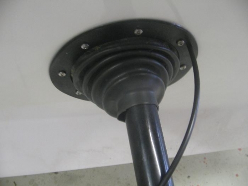

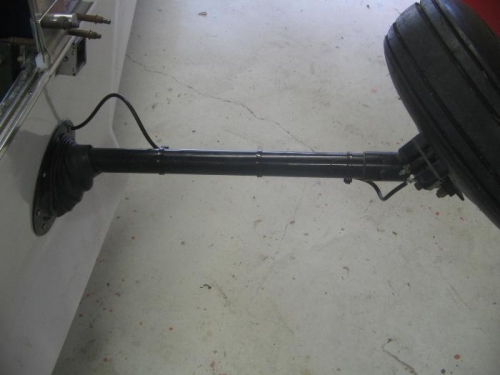

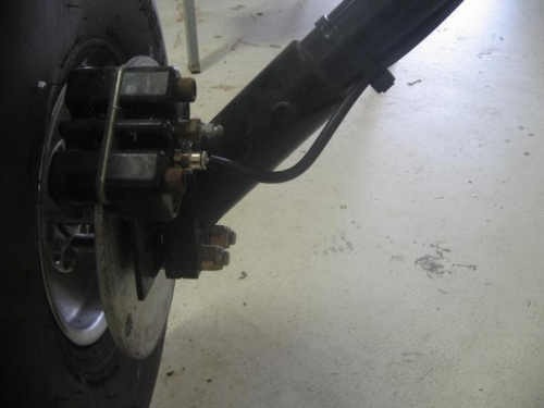

routing brake lines
Drilled holes in gearboot rings and ran black tubing through as a sleeve for the brake lines. Sealed gearboot rings at hull with silicone sealer.
