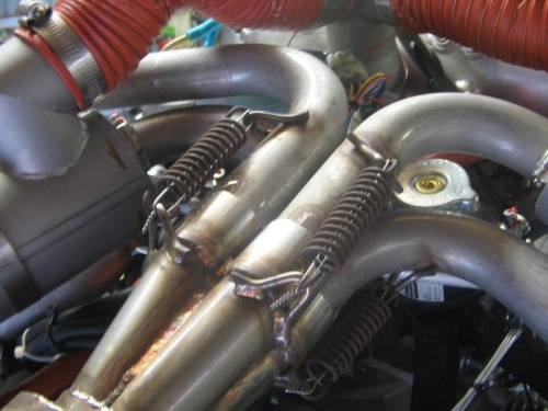

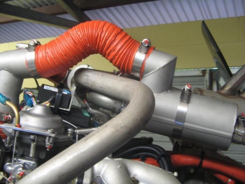

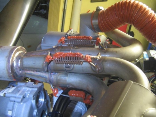

Fitted exhaust and safety wired exhaust springs. Ran lines of hi temp RTV silicone over each spring in case they break to stop parts going through prop. Installed carby heat system.
springs safety wired
silicone on springs
carby heat system
