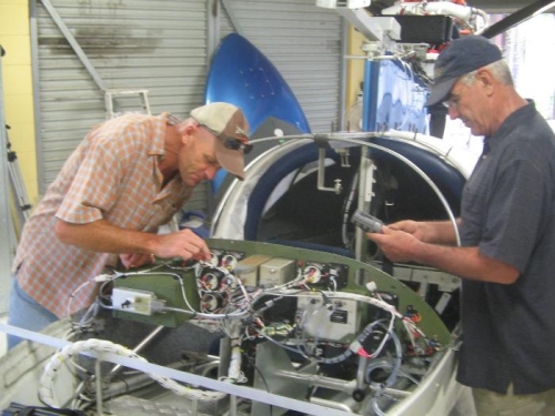

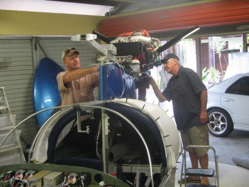

Brief Description:  Inspection by Paul Williams and Mark Davenport
Paul Williams fellow Searey builder and Mark Davenport, LAME stopped by and conducted general inspection. Mark Inspected the engine fitting and suggested I curl ends of safety wire to stop snagging fingers etc. He also suggested sealing the ends of the firesleeve with hi temp silicone to stop oil contamination.. Paul suggested a better way to attach throttle cables and some wiring tips..
