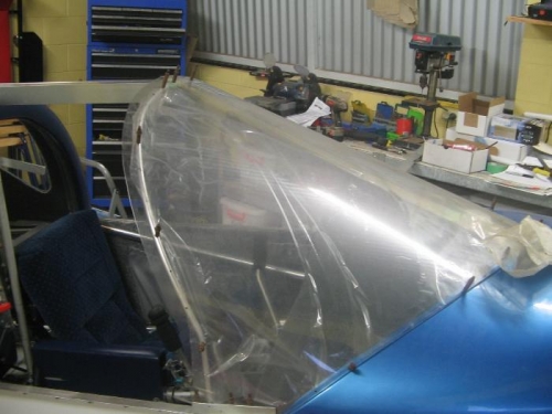

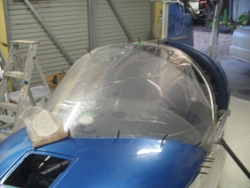

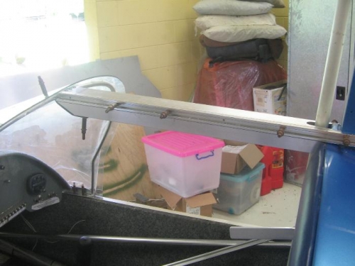

heating windshield
Fitted nose deck and windshield temporarily so I could assemble and fit sliding canopies. Heated corners of windshield at 140C to hold the shape better and lessen stress at those points.
