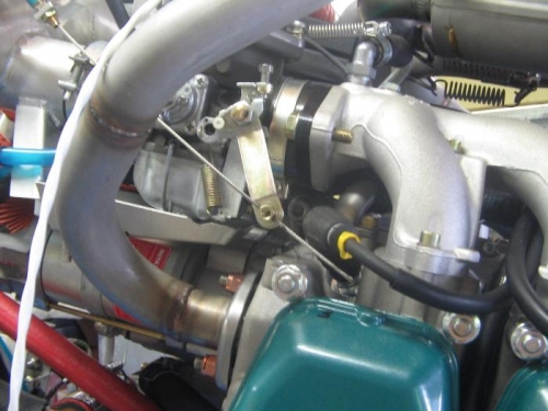

throttle arms
Reversed throttle arms due to pusher configutration. Engine will now go to idle if throttle returm spring breaks.
