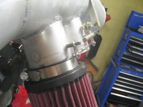

Fitted supplied K&N air filiter and found that the carby heat linkage kit on the filter. Removed linkage arm and fitted it on top of butterfly arms for clearance.
linkage moved from this position underneath butterfly arms to on top of arms
