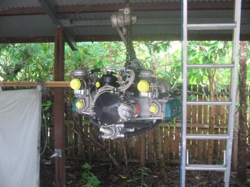

getting engine ready to fit

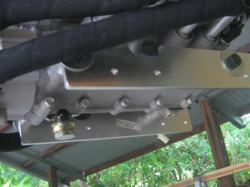

Made up bracket for lifting engine. Lifted engine and changed return in sump from front of engine to rear to ensure pick up of oil on take off.
