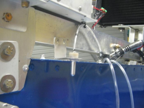

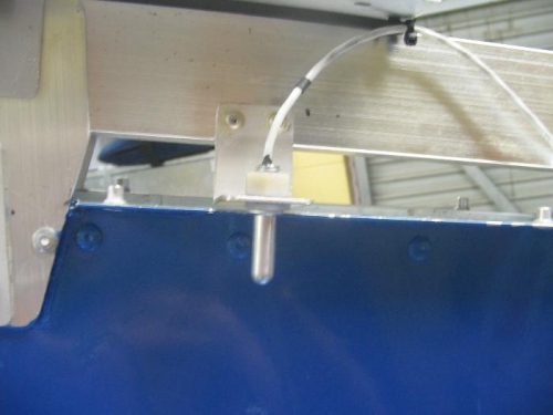

Made angle bracket for OAT sensor and riveted to root tube. Drilled hole in lower gap seal and fitted rubber grommet where sensor protrudes.
