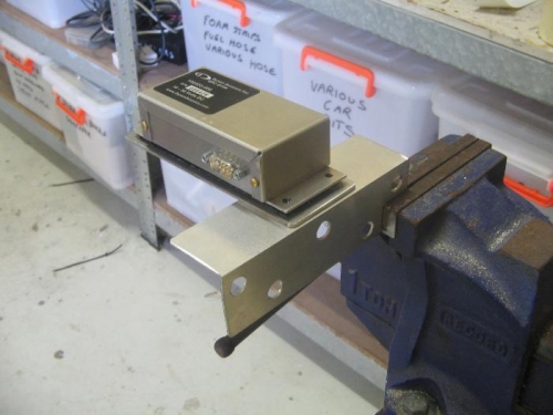

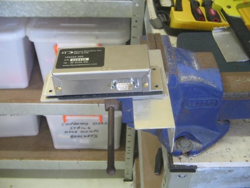

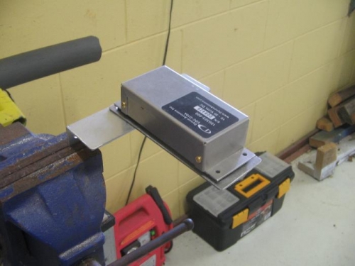

Brief Description:  Dynon remote compass bracket
Made up bracket for remote compass out of ally and riveted together with ally solid rivets. Compass is attached to bracket with velcro and bracket will be bonded to hull with AVS to ensure no errors due ferrous materials.
holes drilled in rear of bracket to help bond to hull
