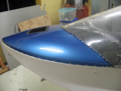

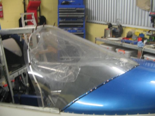

Brief Description:  riveting nose deck & windscreen
Riveted nose deck to hull with ABL 4-4 rivets. Ran a bead of Sicaflex along front of windshield edge and riveted windshield in position with a combination of ABL 4-6 and ABA 6-6 rivets. Oversized the holes in the Lexan and used nylon washers under each rivet head where it rivets through Lexan and stainless washers on the inside..
nose deck and windshield riveted in position
