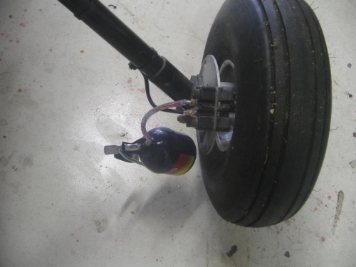

Brief Description:  bleeding brakes
Bled brakes by turning master cylinder in hand brake upside down then pumping fluid upwards from each caliper to the master cylinder. Once filled with no air bubbles tightened up bleed valves and reassembled the hand brake. Tested the park brake with positive results. Used Dextron III automatic transmission fluid as brake fluid as instructed by PA and handbrake manufacturer.
used oil can to pump fluid from caliper to master
