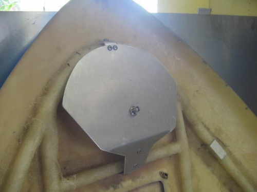

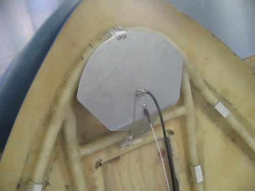

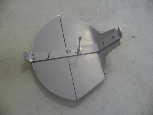

transponder antenna ground plane
Made up ground plane for XPNDR antenna. Mounted it as far forward as possible to keep max distance from crew. Shape is irregular due to clearance for toolbox lid.
XPNDR antenna mounted on ground plane
ground plane attached to nose deck
with coax connected and ground wire attached.
