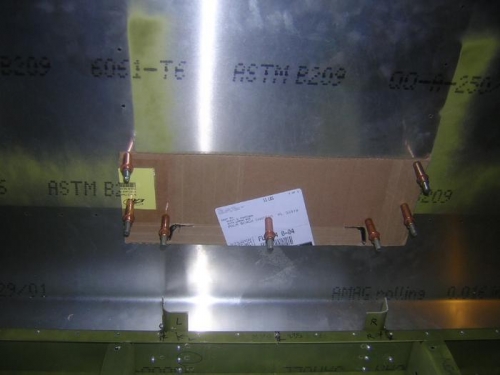

Had to modify attachment points of stabilizer
This modification was made because I had decided to use the one-piece fuselage skins and they required this modification from the earlier plans

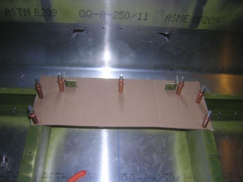

Using cardboard to locate new position of attachment
Transfer cutout to top skin of stabilizer
