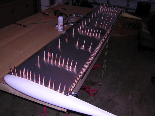

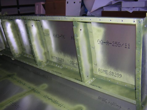

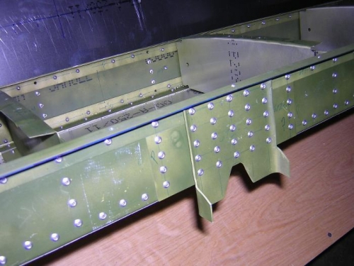

Installed ribs and spars, zinked and riveted each part of Stabilizer. Fabricate and install stabilizer attachment.Note on bottom of stabilizer (Image 1) that I used double rivets in an up/down pattern to account for the first row being too close to edge of skin. Place skin on skeleton, zink and cleco in position (see image 3). Install stabilizer fiberglass ends and cleco in position. (See image 3)Currently using the smaller table. When wings arrive, will build longer table.
