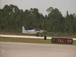

Engine is a 100HP Corvair with 66" Warp Drive prop.
For those who mentioned that I was running hot previously, let me note that I cut the openings of the 601cowl to the recommended diameter of 4 7/8" (actually mine missed the mark slightly as I cut it to just 4 3/4") Previously, I had not made the cuts to the nose bowl and my temps got fairly hot.
Here are the numbers I encountered during the high speed taxi and just after the first true flight along with the time of day.
Activity Taxi ---High Speed Taxi--- Flight
Time 11:45 11:58 12:10 12:30
Fuel Pres 4 2.9 2.9 4.3
Oil Pres 50 40 30 40
Oil Temp --- 190 225 228
CHT-CHT 200-350 250-350 250-350 200-320
EGT-EGT 800-1020 850-1050 800-950 750-950
RPM's 700-1200 2500 2550 2700
Voltage 12.2 12.2 11.9 11.7
The two high speed taxis were between 11:58 and 12:10. The actual flight around the pattern was just before the 12:30 data (the 12:30 reading was after taxiing for about 4-5 minutes)
