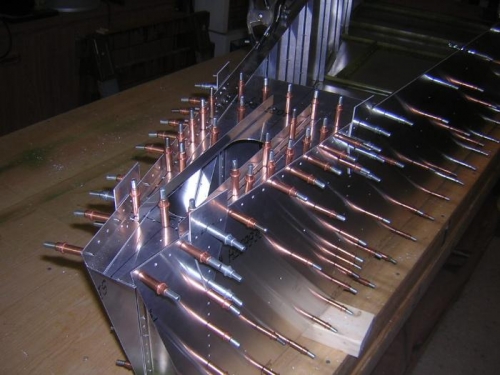

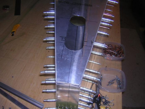

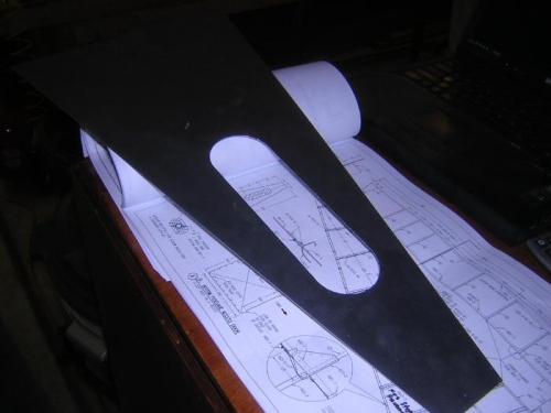

I used a circle cutter to make the rear panel cutout per instructions in the photo guide. After drilling and securing it to the HT Frames (I also had to trim it slightly as it didn't fit the first 2-3 times), I then straightened the fuselage so that a square could be placed against the sides of the fuselage and be "square". Also, a check of the level of the table was made and corrected before using the plumb to check for centerline.Cut two l channels for the reinforcement along the cutout and clamped them into place and then clecoed them.The Front and rear HT attachment brackets were then drilled and attached to the two frames on both side of the fuselage as seen in photo 3.
