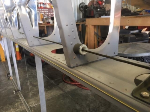

Aileron cable run
Added the cable run. I used two fairleads to handle the directional change. One would have been within the maximum 3* restriction. I used the second fairlead to reduce the change at each one to about 1*
