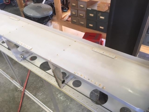

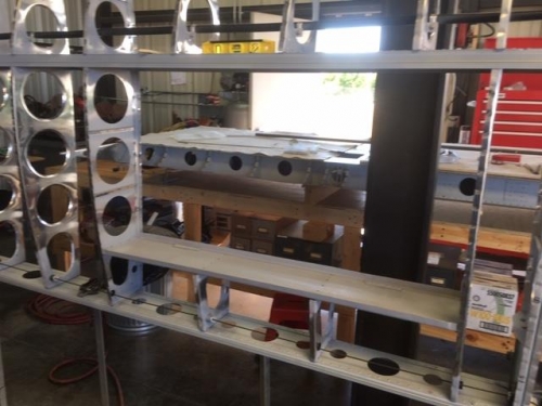

Added the doublers for the fuel tank retention straps (image 1 and 2.) The first builder placed doublers on both sides of the false spar, the plans called for only one. So I decided to make the wings alike and add the additional doubler.
