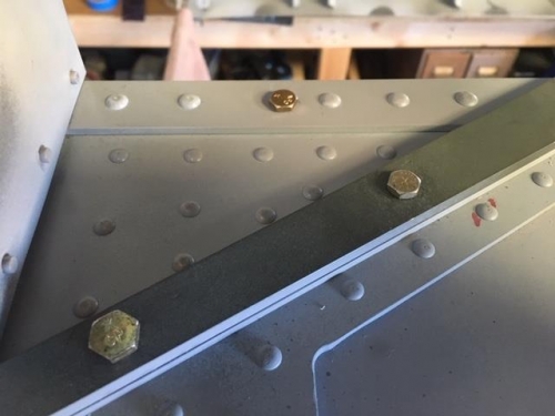

More work on the wing. Drilled mounting holes in the spar and spar doubler for the aileron pulley mounting bracket (image two.) There were two holes(0.250 & 0.1875) that need to be drilled for the bolts of the aileron pulley mount. I also started mounting the pulleys to have the aileron cable system installed in the wing.
