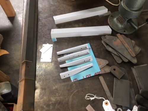

1. Welded bushings into the flap support structure, no photos. A friend did the welding

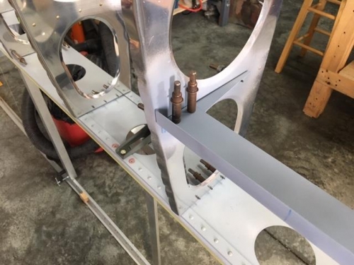

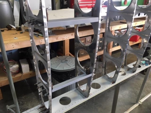

2. The previous builder put in the support structure for a wing fence on one wing but not in the second wing. I drilled out 16 rivets and fabricated six flanges. The images show the flanges and their placement in the wing. I do not have the correct size rivets so that task will be accomplished in a day or two.
3. Fabricated and installed the support flange for the flap torque tube support at the root end of the wing.
I will post additional photos tonight.
Flanges primed

Clecoed in place between rib 9 & 10
