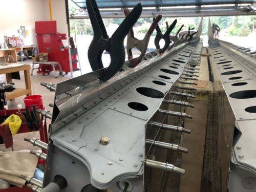

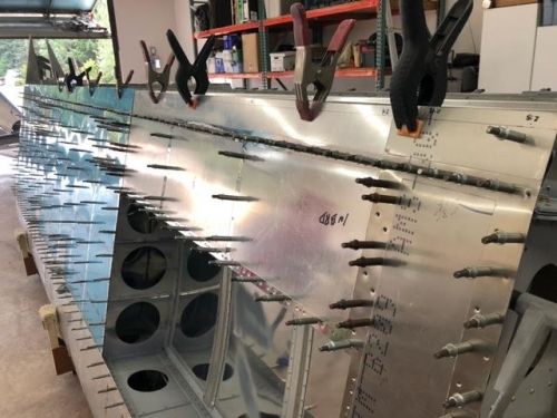

Aft skins
I moved the wing over to the wing rack to work on the lower aft skin. The skin to spar rivet holes were already drilled so after marking a center line on the stiffiner I clamped it in place and matched drilled.
