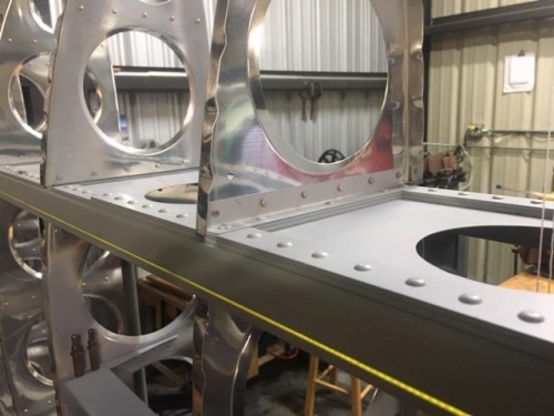

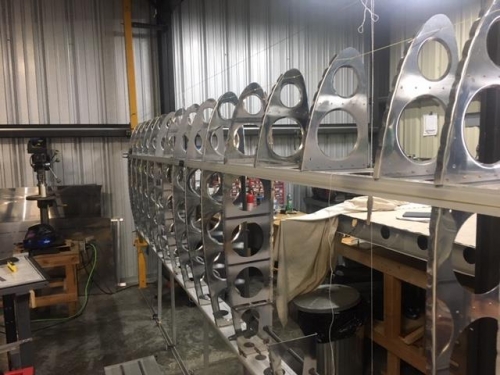

Finished nose ribs
Finished riveting the nose ribs. There is a few tasks that need to be accomplished before riveting the main ribs.
1. Plan Pitot / AOA routing
2. Install conduit for the wing wiring
3. Predrill nutplates for the wing fence.
4. Fine tune the fit of the flap torque tube and its bushings.
5. Install the aileron cable support
6. Install the farleads for the aileron cable.
As you can see, quite a few things. The main ribs could be riveted before some of these tasks, but I want to make sure I don't miss anything.
