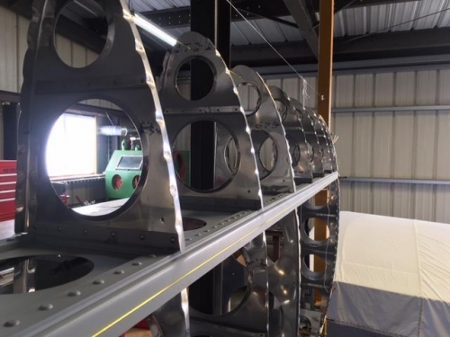

Continued working on riveting the nose ribs to the wing spar. The point where the wing strut attaching support structure mounts to the wing spar needed some additional work. The flanges had not been riveted to the spar as you can see by the clecos in image one. The hole in the center of the image has not been drilled all the way through the spar. And you can see a mark on the spar above and slightly right of the hole. That marks another hole that needs to be drilled.
About half way done with the nose ribs. No rush.
