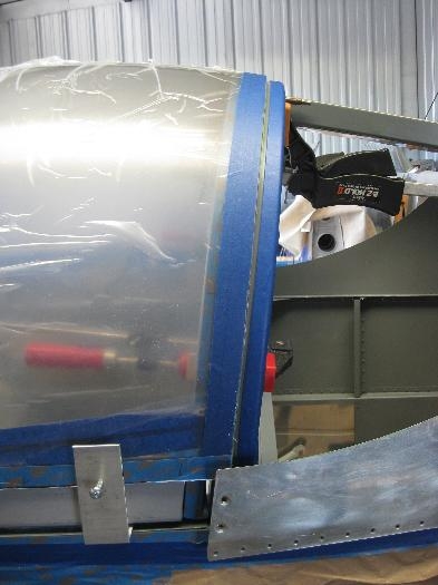

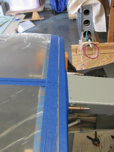

Brief Description:  Canopy fitting - 03
The aft edge needs 1/8" separation from the forward edge of the aft window. This will allow for expansion during hot days when the aircraft is sitting outside. Some folks have complained about heat expansion to the point of binding which prevents the canopy from opening. So I am leaving a little extra space. The grey line is 1/8" separation
Left side
Left side
Top
Top
