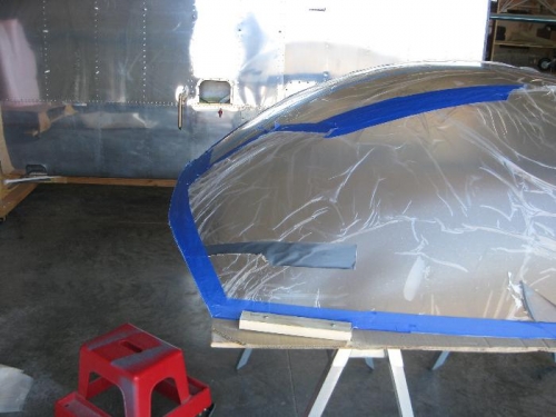

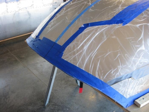

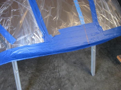

I cut the forward canopy back just a little bit more today. This morning I laid out a line in an effort to get both sides to somewhat match. I am using the canopy frame skin and forward row of rivets as a reference line. Then measuring every other rivet hole to the canopy to try to be consistent. I believe I cut as far as I can on the forward edge before the "big cut." The sides have pulled in and the top is closer to the roll bar.
Hard to see, but there is a black line
