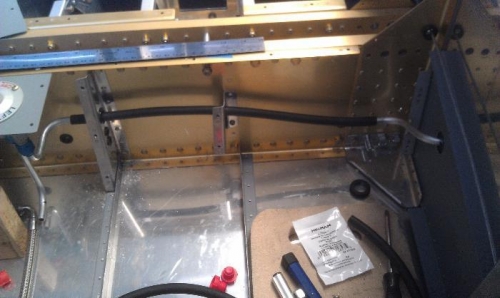

Brief Description:  Cabin fuel line fabrication - 04

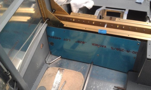

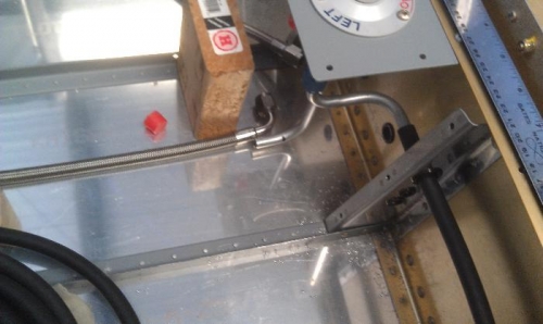

Again I made a mock up from aluminum tubing with two 90 degree bends to allow the line to go through the side of the fuselage without any tension or twisting (image 1.) You might notice the fuel line seems to descend from the center bracket the the bend near the fuselage. Remember the plans have you run the aluminum tubing through the bottom holes in the brackets. I am going through the top. There is a protective cover that goes over the top of all of this (see image 3.) That cover comes with a hole (and the grommet) designed for the fuel line. I could have run the fuel line straight, but would require fabricating new covers. I am going for the descending fuel line and using the existing covers.
Fuselage passthrough
Fuel valve to fuel pump
Protective cover
Protective cover
