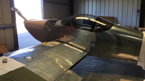

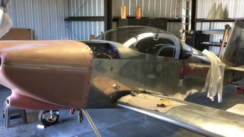

I have not posted on my build log for some time now. I was out of town for awhile, but really I just have not been sitting down and entering what has been going on. And a lot has been done since my last post.

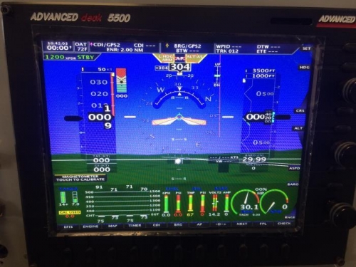

All the electrical and avioncis are installed and tested. Remaining is the official transponder check.
All hydraulic systems are completed and tested. The brakes have been bleed. The fuel system has been completed and tested. Those tests include the fuel level float calibration for the EFIS. Each tank calibrated in 2 gallon increments to 20 gallons, both in the ground and flight attitudes
