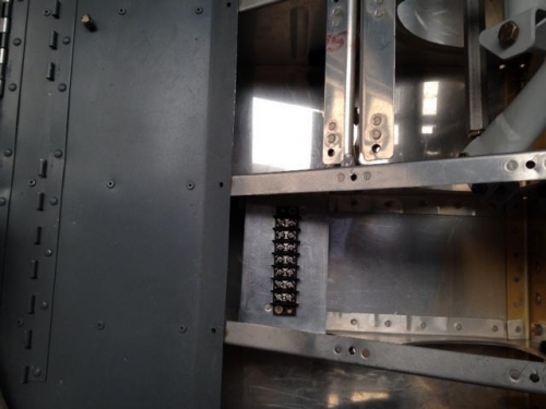

Worked on small tasks that need to be completed. I finished the terminal block for the autopilot system. It is mounted under the Co-Pilot's seat. The shelf is riveted to the ribs and the terminal block is screwed to the shelf using number 6 screws and platenuts. I will run the wires as soon as I finish drilling one more opening in a rib.

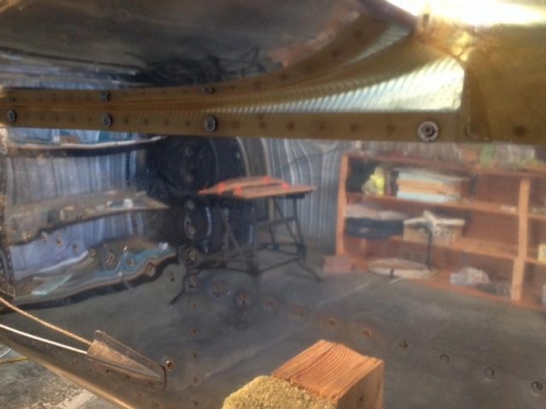

I riveted the longeron (2 places) under the horizontal stabilizer. You can not see it in image two, but I drilled out five locations when I was using the fairings from Vans. After switching to Fairings-etc I decided I only needed four (one each side.)

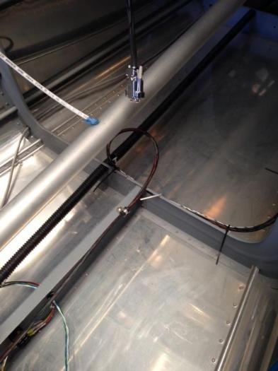

Finished attaching the Adel clamps for the ADAHRS cable running from the net hub to the ADAHRS unit.
