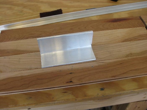

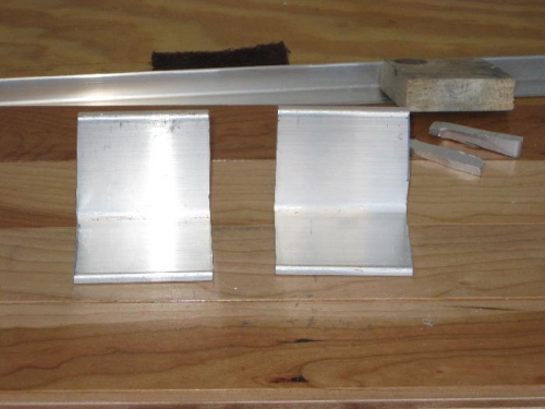

The next piece I needed to fabricate was F-705G, which is a bracket made from 0.187 (read thick) angle alum. It is part of the structure of F-705 AND it is where the canopy locks into place when it is in the down position. It is relatively easy to make, cutting it to size but the outboard side of each piece is angled inward 1/8th of an inch. You may be able to notice in the photos.

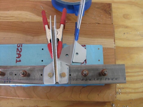

Seatbelt bracket trimed for rivets
F-705G before fab
F-705G before fab
F-705G after fabrication
