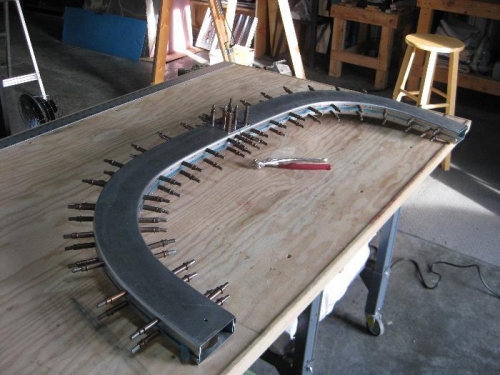

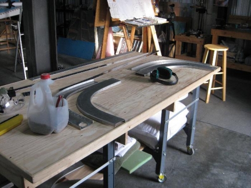

Brief Description:  Canopy frame - 01
Worked on fabricating / assemblying the aft canopy frame. This rather beefy section doubles as a roll bar in the unwanted event of the aircraft arriving upside down. As usual I did not take photos along the way. So two pictures of it assembled and drilled, one of everything back apart for deburring, countersinking (for flush rivets) and some limited priming.
Assembled and drilled
Apart and ready for deburr, etc
