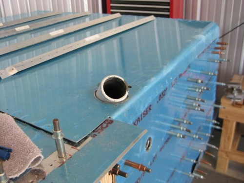

Number of Hours:  3.00
Brief Description:  Landing gear weldment

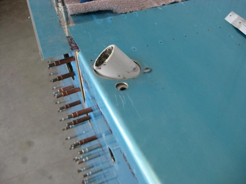

Working on trimming the bottom skin (F-712) so the landing gear weldment will fit through the skin and mount against the center section. A lot of trimming, check the fit, trimming, check the fit...repeat several times for both sides. The plans have you complete this task after riveting the fuselage is riveted together. It was much easier completing this task before hand.
The small hole is for the brake line.
