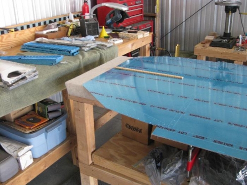

Today I took the center section apart for dimpling, countersinking and the rest of the chores required before riveting the whole thing back together. I finished all the ribs and got the skin ready for dimpling. Of course, there were the usual conversations as folks walked by the hanger. Part of the process. I plan on having the Center Section back together and riveted next weekend. Then we join the center and aft sections together.
