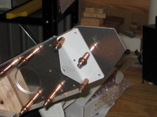

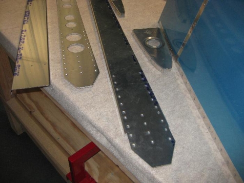

Started today by drilling the bottom holes in the bottom hinge for the rudder. For 7As you can drill them now, for the tail draggers you wait until later. Once that was completed I dimpled the leading edge of the rear spar (only those at the bottom portion as the plan requires) and then countersunk the corresponding holes on the spar stiffiner. After that I double checked the edging of all the components and prepped them for primer. It is raining today so instead of shooting primer I set that aside, cleaned up and headed for the house. There are some tools I want to order and I am going to order tie downs from Cleveland Tools so they are ready to attach. I think I can attach the tail tie down now.
Drilling bottom hange rivet holes

Ready for sanding and priming
