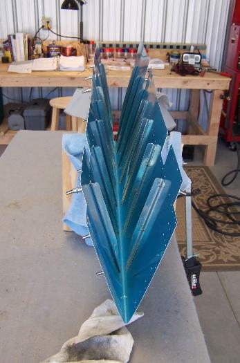

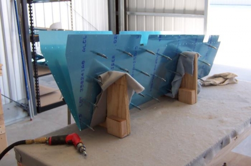

Finished cutting the stiffners to size for the right and left elevators. Last time I was working on the stiffners I managed to mis-measure the length of stiffners for the left elevator. They probably would have been fine, but I decided to replace them. The replacements came in on Friday, so today I cut the new stiffners to the correct length. After I was satisfied with the stiffners, I drilled to match the rivet holes and dis-assembled the elevators for dimpling, sanding and priming.
Right Elevator
Right Elevator
