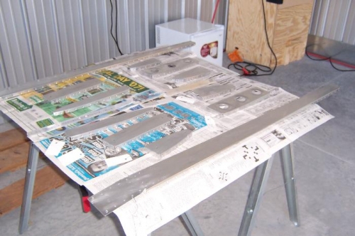

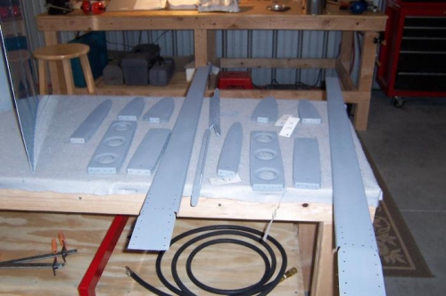

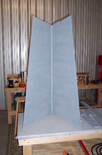

Deburred, dimpled and sanded for several hours today to get the HS parts ready for priming. I took a short break for dinner and then went back to the hanger to prime the HS parts and the inside of the HS skins. Before the skins were ready to prime I needed to finish the task of dimpling all the rivet holes. Most of the holes to dimple were reachable by my hand squeezer, but there were several that could only be reached by the C dimpler. Unfortunately, due to the fold in the skin for the leading edge I could not dimple and hold the skin at the same time. My lovely wife came down and helped finish the task.
Ready for priming
Ready for priming
Primed
Primed
One of the skins
One of the skins
