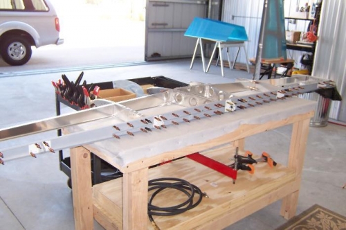

Date:  6-24-2007
Number of Hours:  5.00
Brief Description:  Horizontal stabilizer continued
Today I finished all the fabrication for the left side of the HS. All of the tasks are a repeat of the right side, so the work went much faster. I did drill one set of holes the incorrect size. In a momemt of confuson I drilled the holes in an end flange of a rib too large. Fortunately the oversized holes are still within the distance tolerances for rivets. That is the distance from the edge, I will just move up to the next size rivet. The next step is to take everything apart and sand, debur and prime.
Aft end of the HS all ready for sanding
Forward edge of the HS
