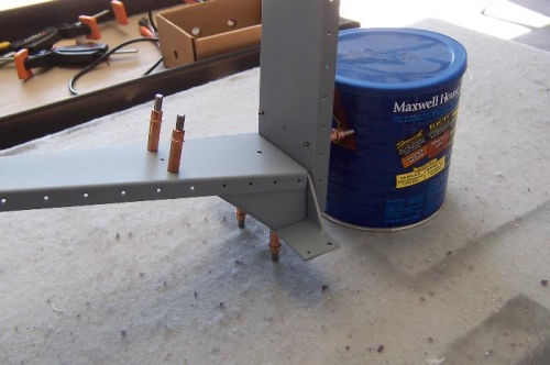

The final work of the day was to cleco everything together to ensure proper fit and drill to match all of the remaining rivet holes. There are almost three hundred rivets on the rudder skin. That is a lot of rivet holes to cleco, drill, deburr and countersink / dimple. I can only imagine working on the wings. After drilling to match I took everything apart and went to work deburring and dimpling the rudder structure. Although the plans have you complete a few other tasks before priming I went ahead and prepped, cleaned and primed the rudder structure components.

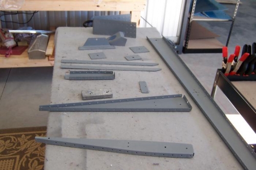

Primed ready for final assembly
Two long strips frabricated and shim (in background)
fitted for riveting.
