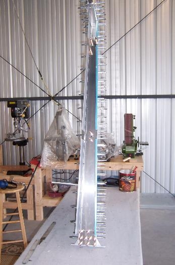

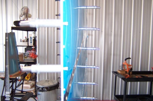

This afternoon I only had a couple of hours to work. The first step called for clecoing the rudder skins on both sides and drilling to match. The first skin (left side) went on a little tight, but it seemed to fit alright. Of course that little voice was saying "This doesn't seem right. Nothing is ever this tight." But I motored on anyway. As I was clecoing the right skin in place I noticed it was really tight and it looked like it was starting to get a wave in the skin. That was definitely not right. I started to take the skin off when I noticed one of the stiffners on the inside was about 1/32 too long. It was hitting one of the hinge stiffers mounted on the spar. On closer inspection I found two of the stiffners were about 1/32 too long on the right skin. I went back and checked the fit on the left side and found a stiffner that was too long on that side as well. I spent about an hour with a file slowing taking the upright portion of the stiffners down a little. The rudder skin is only 0.019 thick, so I needed to make sure I did not scar it in anyway. But with patience and time I took off the required amount to get the fit I wanted. The skin clecoed in place without any stress on it at all. I want this aircraft to fly "hands off" so making the rudder skin is smooth and straight is kind of important. The trailing edge seems perfectly straight so far.
Rudder skin clecoed in place
