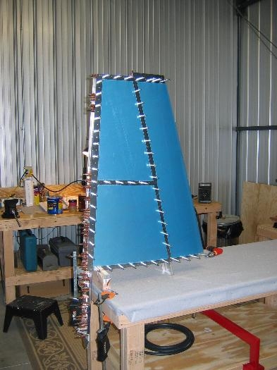

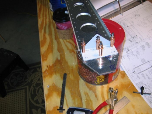

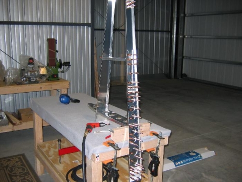

I have been on a business trip for the last few weeks and got home yesterday. While I was gone the parts that I had to order from Van's arrived. The forward VS spar and one part from the HS needed to be replaced. I removed the old forward spar, clecoed the new one in place and drilled it to match. After checking all was okay I clecoed the VS skin in place (picture one) and drilled all holes to match. The next step was to break everything down and dimple. de-burr, counter sink and radius the edges of all the parts. After taking the skin off I decided to drill the two lower holes to match the drawing on page 27A. These holes are used later when the empennage is attached to the fuselage.
New forward spar in place
VS skin clecoed
VS skin clecoed
Drilling the lower two holes
