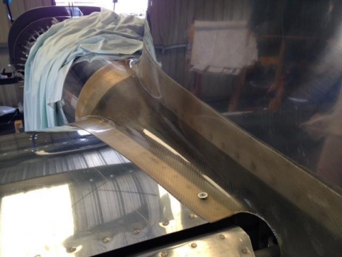

Brief Description:  Tail fairing work - 01
Spent the day working on the tail fairing. I am going to leave it at this stage for now and come back to it later. It is about 95% of where I want it.

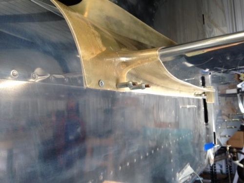

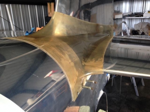

In image two you can see three clecos. The first one is where a screw will go for the main fairing and the other two are for the fairing under the HS. I would like to keep the screw count on the main fairing to four per side, two at the front, one on the HS (see image three) and one on the VS. We shall see. I also trimmed the lower fair to match the skin line of the fuselage skins.
