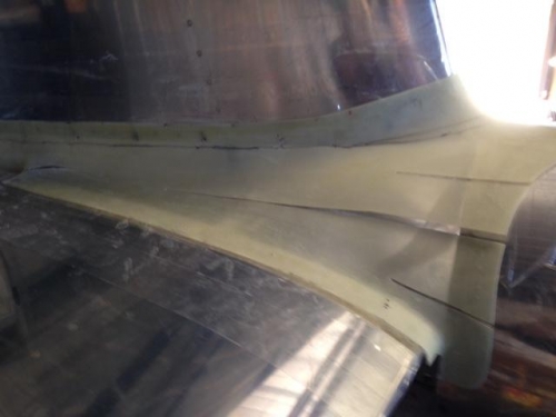

Continued work on the lower rudder fairing and the tail fairing. The lower rudder fairing is not going well. I ended up sanding through the work I did yesterday. So I worked on that repair. There is some interference from the fairing when the rudder gets to each stop. Not sure what the problem is, but I will need to figure that out.

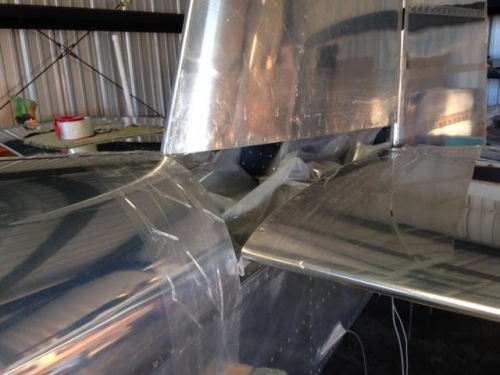

While the rudder fairing was curing I went to work on the tail fairing. It fits horribly. I took it off and covered the tail in shipping tape. I wanted something to protect the aluminum and act as a release. I will need to cover it in wax when I start working on extending the layups I did today.
Today my goal was to get the fairing to lay flat on all its edges. You can see that I finally started hacking the fairing up. I used my dremel tool and anywhere there was presssure preventing the fairing from laying flat I cut into it. You can see in image three how a portion of the fairing wants to pull away. I almost cut it in pieces. But now it lays relatively flat, except for one edge. I will need to build it up and sand it down to normal thickness from the top.
Packing tape for protection and release
Left side cut up
Left side cut up
Right side looking bad
