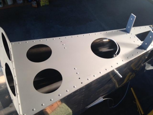

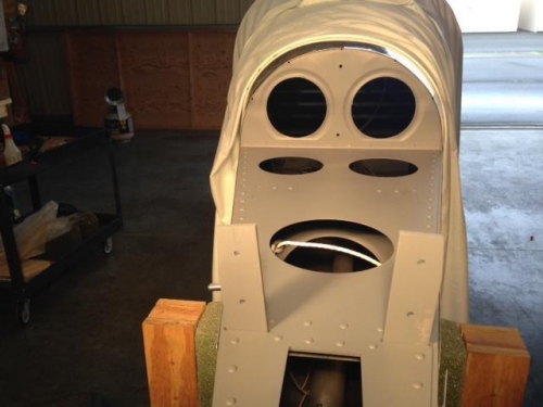

Continued with my inspection of previous work. I went over the aft section of the fueslage so it would be ready for the tail section assembly. I found a few rivets that needed some attention, none that needed to be drilled out. But six or so that needed to be set better. Fortunately I could reach all of them with my squeezer.
After all the work the top deck had some scratches in the primer. Probably from taking the tail off, setting tools down, etc; so I sanded and reprimed the top skin. The photos were taking after the work was completed. The second image makes the aircraft look like it has a serious twist, but just the illusion of the photo.
