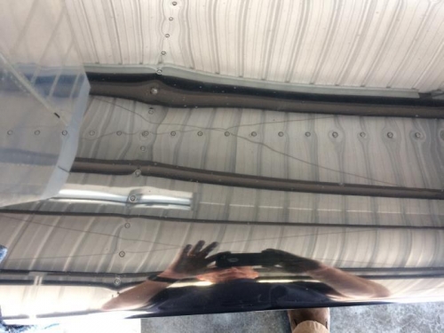

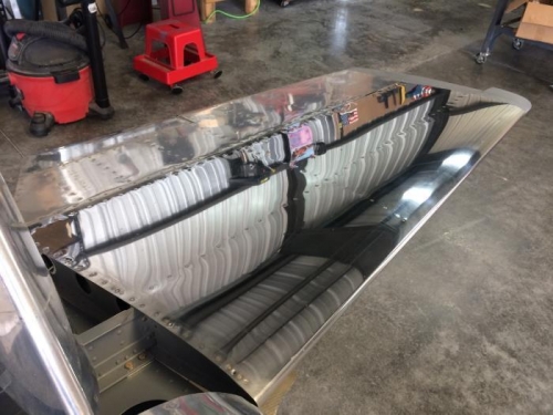

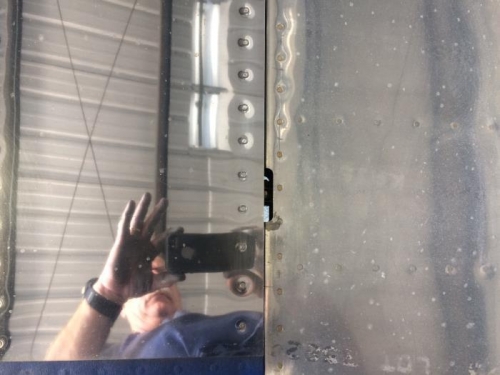

I have decide to polish the aircraft instead of painting. Today was an initial test of one technique using a product CaliforniaCustom. This is a two part cleaning and polishing system. I plan on using this all over the aircraft and then just on the bottom of the aircraft. The final polish will be with a cyclo buffer and polishing compounds from PerfectPolish
The first iimage is looking down on the left horizontal stabilizer, I am facing aft. The second image shows the polished horizontal stabilizer and the left elevator. The horizontal looked like the elevator before I started. The third image was taken looking across the aft fuselage
