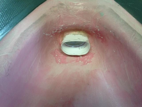

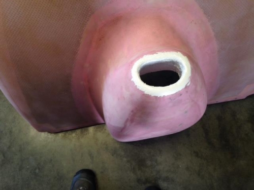

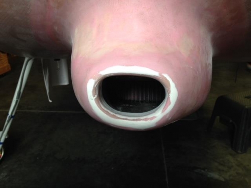

Brief Description:  Snorkle extension
Work progresses along although slowly. I applied a thick micro epoxy solution to the mouth and interior of the extension and then sanded, sanded and sanded. After mounting the cowling back on the aircraft I marked the aft edge of the extension and began a process of trimming, mounting, marking and trimming again. I have about a 90% solution at this stage. A little more trimming in one quadrant and this will be finished.
