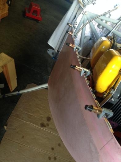

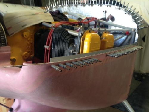

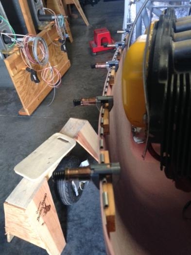

After school I worked on mounting the lower half of the hinges on the lower cowl. First I drill the rivet holes in the bottom hinge 5/64". Then I clamped each hinge in place as Vans plans state, letting it rise just a little on the aft edge.
Image one and two show the right side clamped ready to drill. Image three shows the left bottom hinge drilled and clecoed in place. There are four holes not drill due to the valve cover. I will have to pull the cowling to get to those.
