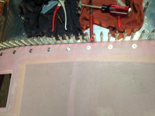

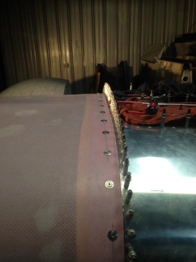

No photos, I will try to take some tomorrow. Installing the Skybolt fasteners on the upper cowling. There is a small issue with the cowling and forward skin alignment. When tightening the Skybolts the cowling will be about 1/16" below the top forward skin. My solution is to lay down a single layer of fiberglass on the inside of the cowling to raise it up to the level of the skin. The lower cowl is ready for sanding the final (I hope) coat of epoxy used to fill all the various pits and pin holes.
