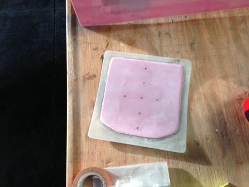

In between cowling epoxy applications I turned to other tasks. The oil door needs to be finished. Earlier in the week I epoxyed the remains of the cut out to the bottom of the door to add strength. The small holes you see are epoxy rivets. Small holes drilled in the bottom portion that fill with epoxy when clamped in place.
Image two shows the door sitting in place. Now on to the hinge.
