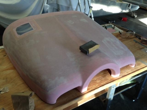

Continued work on the cowling. Image one shows the upper cowling during its final stages of sanding. Still working on the forward edges around the air inlets. I did not take a photo but completed the intial sanding of the lower cowling, an application of epoxy to seal the honeycomb area, another sanding after the epoxy cured and another epoxy layer on the bottom of the cowling.
I have decided to work the bottom cowl in stages. First the bottom, then one side and finally the other side. The epoxy wants to run on vertical surfaces so instead of coating every surface I will work on one at a time.
