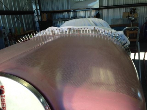

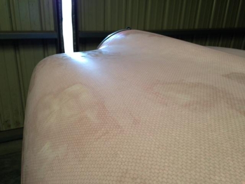

Brief Description:  Guess what - more cowling work
After three hours of block sanding I finally got down to what you see in images one and two. The cowling is wet in the photos. I used a damp rag to wipe it down after blowing all the dust away. I found a few locations that needed a little more attention, so I mixed up some microballon and epoxy and filled those locations using a squeegee. I will get back to those tomorrow.
