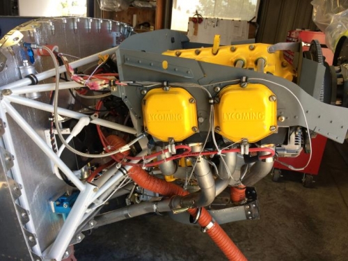

Since my last update. All sensors are now wired and tested. I had to pull apart two harnesses and rewire them. There was a misunderstanding in between the Dynon and AFS documentation. Now that I have that resolved the volt meters work. It did eat up a few days of troubleshooting and emails before it was resolved.

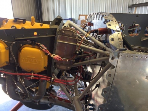

The oil cooler has been reinstalled. Now I am down to a relatively short punch list of items to finish. Should be ready for engine start in the next few weeks.
